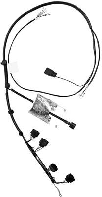

    this is a note from Carlo Vogelsang re: how he did his wiring harness - I don't know if the harness p/n would be the same for your engine code. You need to find out.
    Coilpack harness: 1J0971658L ($37 at worldimpex)
    Coilpack harness heatshield: 8L9121659 ($44 at worldimpex)
    "It's offically for a AWD Golf, but since the ATC engines are basically the same the harness fits perfectly. Install took me about 3-4 hours, getting the pins out of each of the connectors is the hardest part. I've attached
    the TSB as well (has all the instructions)."
