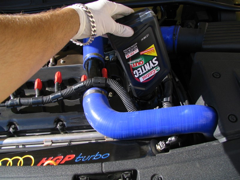

9. Finally, the most fun part: fill'er up with new synthetic oil!!
HPA's recommendation was to use Castrol's "Synthec" in 5W-50, which I had quite a hard time finding locally. For those in the San Francisco area, Cresta Warehouse on 5050 Mission street carries it along with many other oils.
