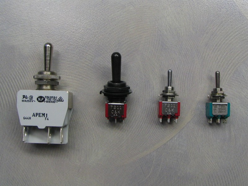

In my mod, I chose a slightly different switch that the R32 guys. It is a DPDT (Dual-Post Dual-Throw) 3-way ON-ON-ON switch, which has 3 different combinations of connecting 6 posts.
Beyond the two leads that will come from cutting the control wire in half, we need a +12V lead and a Ground lead to make the valve close the flap. The sample diagram will look something like this:

Anyway, the switch connections will be explained further in details later, when it comes to actually connecting it.
But for now, the result of the switch is as follows:
1) In the top position, it will only connect the ECU to the solenoid, so you will be in stock mode (as described above)
2) In the middle position, it will connect the ECU to the resistor, and the solenoid will stay disconnected, so the flap will always stay opened and the exhaust will be LOUD :-)
3) In the bottom position, it will also connect the ECU to the resistor, but this time the solenoid is grounded, so the flap will always stay closed and the exhaust will be QUIET.

As I mentioned in the beginning (i.e. a while ago...) the switch must be a 3-way DPDT ON-ON-ON toggle switch in order to "safely" have all 3 modes.
Here are four switches I purchased online, as I couldn't find one with the right specs locally:
From left to right, we have the following part numbers from the manufacturers:
- APEM 644H/2
- ITT/C&K 7211TZQE22
- ITT/C&K 7211SYZQE
- Electroswitch A232S1YZQ
I ended up picking the black ITT one, since it looks the least conspicuous in the TT's centre console. Also its actuator is a fair bit larger than the other two small ones while having the same small connector size.
