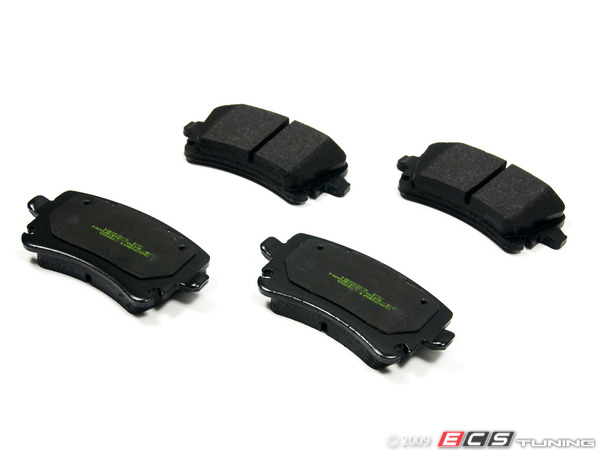

Another option you may wont to consider is Hawk Ceramic pads.
Ceramic brake pads are one of the newest innovations in the automotive aftermarket. With decades in the motorsports arena, ceramic braking components have been tested and abused. Hawk Performance brings this technology to your daily driver with a set of Performance Ceramic brake pads.
The benefits of ceramic brake components are vastly superior to the traditional metal compound pad. Because ceramic does not absorb heat as rapidly, heavy braking in hot conditions will keep your brakes from fading. With a much higher co-efficient of friction, stopping distances are reduced as stopping power is increased. Also, because of their lower metal content, brake dust is all but eliminated. All of this comes with the added benefit of drastically increased brake rotor life.
Click HERE to order or for more information.
