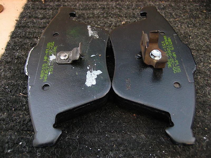

Example replacement (Hawk, ect) pad on the left. Factory OE pad on the right.

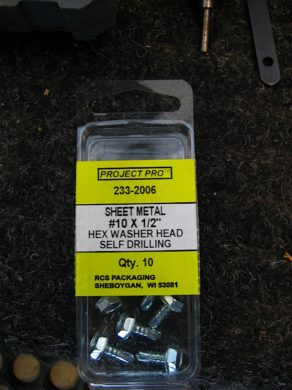

1. One .89 cent package of #10x1/2 Hex head self drilling sheet metal screws.

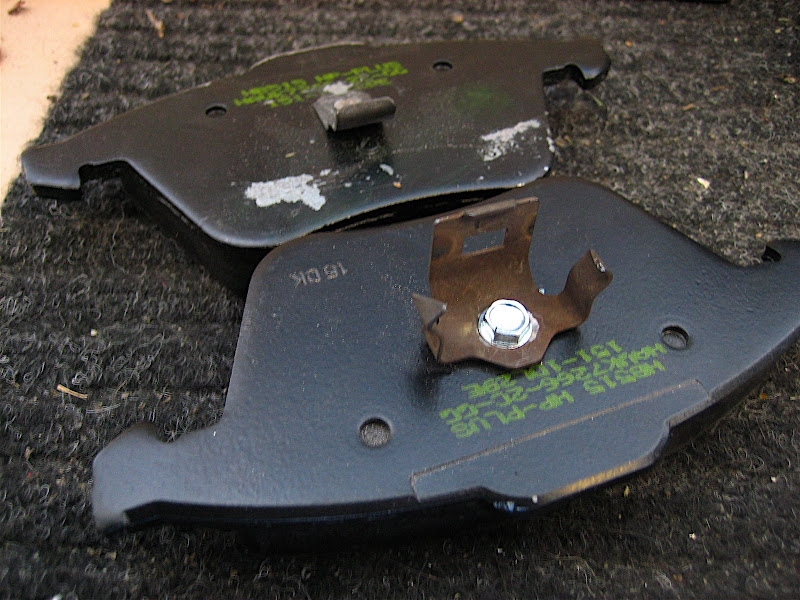

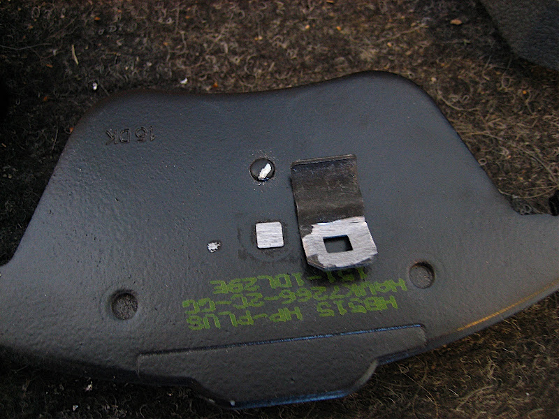

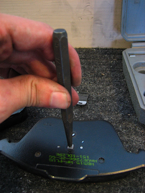

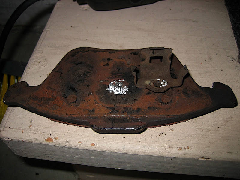

1. Grind off clip from OE pads. (notice the hole that is drilled from my own practice
2. Next grind off the clip on the new pads. Notice I didn't grind away too much. You need to leave some paint so you can identify the center of the square left behind.
3. Line up your center punch.

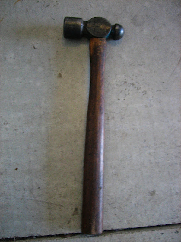

4. Then use your BFH!

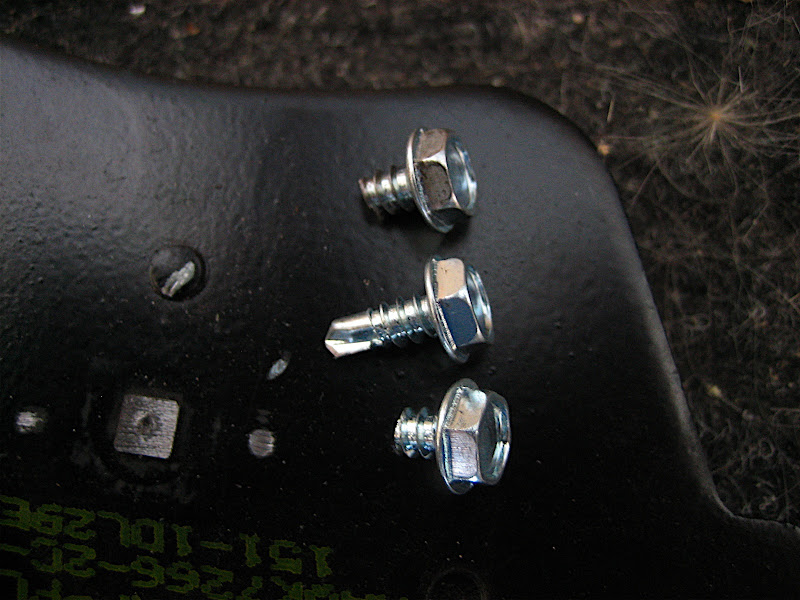

5. Time for power tools! Get out the drill with the 1/8th inch bit and drill a hole in the center of the square where you marked with the center punch. You can measure by putting tape on the drill bit so you know where to stop. Once the hole was drilled I used one of the self tapping screws and a 8mm socket with handle to drive it. I turned it in to make sure the hole was the right size since the drill bit was slightly smaller. I did not go past that self tapping part into the threads. Just used for sizing the hole.
6. Get out the sheet metal screws.
7. Lock the screws in a vice or vice grips and cut off the self tapping ends of two of them with the rotary tool.
They should end up at the perfect length!

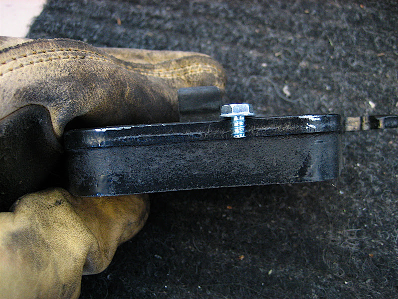

8. Use the 8mm socket with the driver handle or a nut driver, line up the old (proper) clip over the hole on the new pad and start driving the screw. Once it's started I switched to a ratchet as it was pretty hard to turn and required some leverage. Tighten down and your done!
I was able to complete both pads in about 45 minutes. And after driving on the track today for four 20 minute sessions, they held up beautifully!
