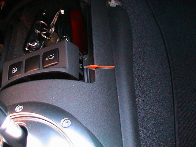

Just got back from Sweden last night and had trouble sleeping past 6 this morning, so I decided to swap the "trunk" and "gas cap" buttons (which I've been wanting to do for a while now).
You see, in a 3.2 TT with DSG, the shift knob in "P" (Park) position makes it harder to reach the right button, which by default is the trunk opening one, compared to the gas-cap button. And since the trunk button is used much more often than the gas cap one, it just made much more sense to swap them so that the trunk one on the left.
Note that all credit for this "mod" goes to Hervé from Switzerland, who got his 3.2 TT a few months ago and decided that the placement of these buttons in the center console didn't make sense. So he swapped them and wrote a procedure here but without pictures.
Today, I bring you a fully-documented and pictorial procedure on how to do this:
1) Lift the buttons' holder, which is simply snapped into the center console by 4 little tabs shown here:
