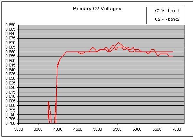

Default I just hooked my new WB (Zei something) and here it is with my o2 reading
I find out I am running little bit rich...
so I am thinking about pulling 2 % more
and below is my o2 reading.. but some how my o2 reading is not consistance.. so I remember Edy and somepeople were telling me I am tap lean.. but it was opposite... I will log more after I pull little more fuel

Default Oh,., some how my RPM is reading pretty high on my wb log.. so JD you need to help me out!!

Default Did you set the software to 6 cyl. engine?

Default wow with my fueling I had to take out 10% just to get to 11.5
you are uber rich. Would help if you had RPM

Default Pull more than 2%, Park...at least 5% IMO.
And learn to ignore the people that evaluate your AFR based on 02 voltages.

Based on your last post and logs, I asked:
"Do you have a WB, if so what does it show, it looks like ur leaning out."
Based on what his NB O2s showed .85v after 5.5K.
NB O2 are not meant to be used to fine tune, however if you don't have a WB or for a *general* idea of what your AFR looks like they are ok.
