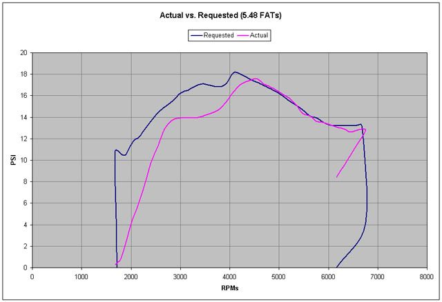

Default here is a graph i found from a long time ago...
GIAC L308X, piggies, ASP catback, 93oct. Not sure of outside temp, prob about 85F. Car was running perfect in this run...

Default same setup and conditions, but the addition of AWE ICs...

Default so im in the .20 sec range of you josh huh, everything looks ok then?

Default yep :) your times after the exhaust sounded fine, but when you said 7.XX with Stg1, that got me
thinking.. thats definitely way too slow..

Default my mods are in my signature and I ran a 5.24 in nearly the same temp/humidity.

Default ic oulda been wrong about my stage 1 times, maybe it was around 6sec? id have to look

Default I ran 5.03 as stage 1 the last time I went...
I have not done with my piggies, but will likely get out now it's cooled off a bit.

Default I LOGGED 020 details inside
i logged 020 like you asked, there are 4 values
the first kw ranges from 6.0 to 5.0 to 3.0
2nd kw ranges from 5.3 to 7.3 to 6.0
3rd kw ranges from 4.5 to 6.8 to 6.0
4th ranges from 4.5 to 6.0 to 5.3
hope these numbers help , i am logging with vwtool
thanks

Default you have values for all rpm ranges? thats means you are pulling timing,,,
what gas are you using?

Default it didnt log rpms with the kw, im running 93 its hot today about 90 out on stock ic's
