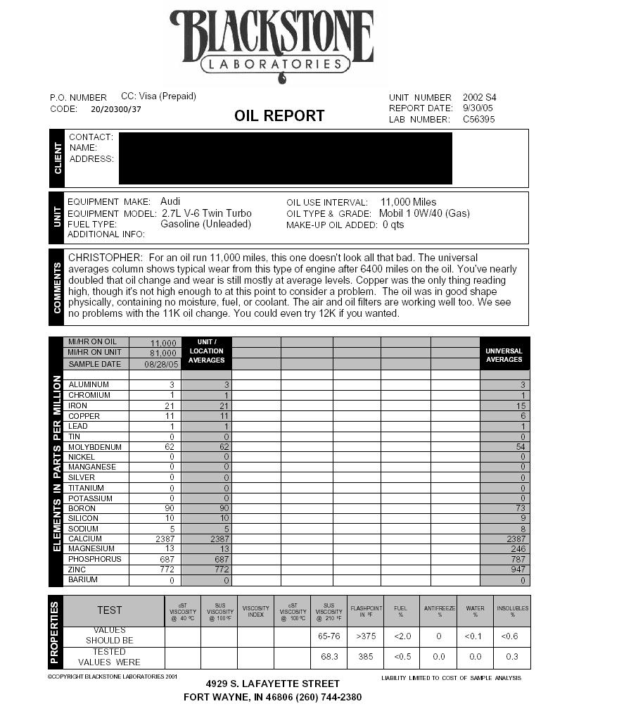

Default Blackstone Oil Analysis Report - 11K miles on Mobil One 0W40
I know, I know... I should change my oil more often, but overall things aren't too shabby for a car with 81K miles on it! I've pretty much always changed the oil at 10K mile intervals too, always with Mobil One 0W40
FWIW, the car was stage 2 (APRv5.0) with stock intake and paper air filter for those 11K miles. The oil filter was OEM as well.
I'd say 90% of my mileage is highway cruising with 10% "spirited" around town driving. There was definitely a bunch of WOT action right up until it was changed. I also used that Chevron Techron stuff about 3K miles before I changed the oil for the heck of it. I didn't noticed any difference though.

Default Good report. You should be pleased. :-)

Default Nice! What interval are you going to try next?
After several attempts, I've settled on an 8000 mile interval on M1 0W40, but I track my car quite a bit.

Default I figure with the upgraded turbos, etc. I should shoot for 5K-8K
I tend to follow the 10K service interval pretty well, so changing oil once between intervals would work out pretty good schedule wise. I think I could probably still get away with 10K intervals though.
