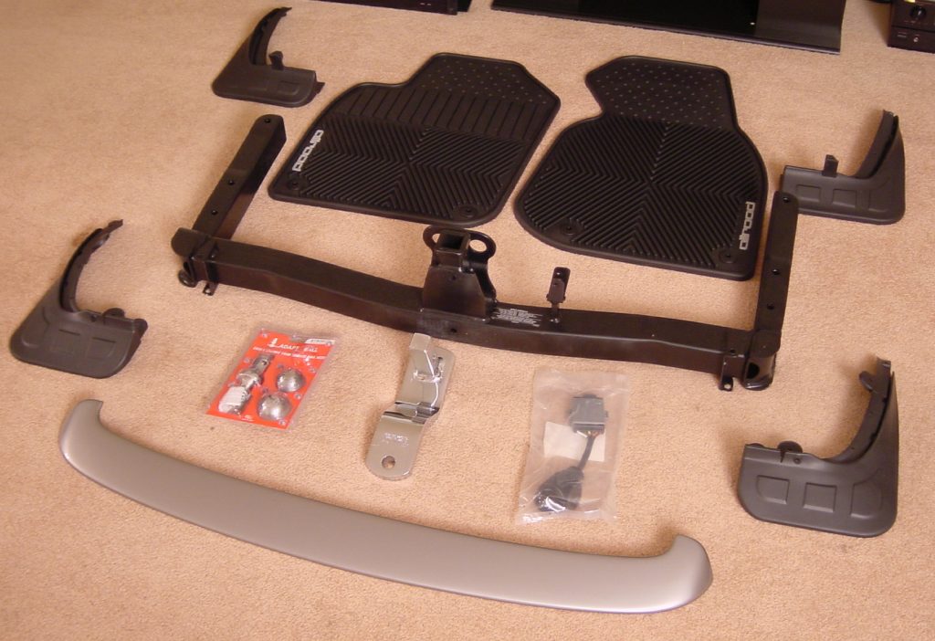

pics from Jbaumgart's pic poster

You might try discussing with the techs at your dealeship, as to whether or not it can be installed on an A6. It's fitted by removing the bumper, and the impact protection structure, then replacing it with a new part...
Picture the u shaped bar going into the car, with the receiver sticking down, towards the carpet, rather than up. The metal tounge then goes into the receiver from underneath, rather than the back, like on most hitches. Then the wiring harness is a part that flips up out of sight when not in use. I'd assume some amount of modification might be required to make this hitch work on a standard A6 - so the no drilling requirement would be defeated. On the plus side, it tows class II/III weight (depending on if one looks at US or UK specs), and is quite hidden.
